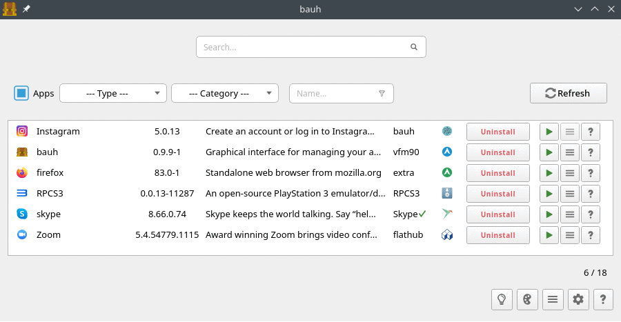

:gear: Bauh – A Manager for Your Multi-Package Needs
  1. Install Dependencies :
sudo apt install git python3 python3-full pipx python3-pyqt5 python3-pyqt5.qtsvg python3-setuptools qtbase5-dev qtchooser qt5-qmake qttools5-dev-tools
  1. Set Up Virtual Environment and Install PyQt5 :
source venv/bin/activate
pip install pyqt5 --config-settings --confirm-license= --verbose
  1. Install Bauh Using Pipx :
pipx install bauh

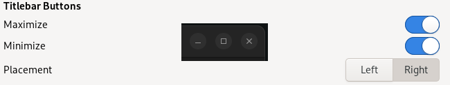

:wrench: Open GNOME Tweaks
Launch Tweaks , and under the “Titlebar” section:
  • :white_check_mark: Enable Titlebar Buttons (e.g., minimize/maximize)
:roll_eyes: (Why is this even disabled by default…)

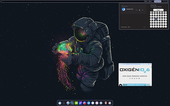

Rice your Desktop
:art: Rice Your Desktop – Themes, Icons, and Shell Style
Customize the look and feel of your Linux desktop using themes, icon packs, and wallpapers.
:package: Step 1: Download Customization Files
Save them to your Downloads directory.
:file_folder: Step 2: Extract Themes and Icons
cd Downloads
# Extract theme
sudo tar -xf Graphite-teal-nord-rimless.tar.xz -C /usr/share/themes
# Extract icon pack
sudo tar -xf Zafiro-Nord-Black.tar.xz -C /usr/share/icons
# Optional: Use another theme
sudo tar -xf Cold-Metal-No-Logo-GTK.tar.xz -C /usr/share/themes
:open_file_folder: Step 3: Create User Theme & Icon Folders (If Needed)
mkdir -p ~/.themes ~/.icons
:closed_lock_with_key: You can also change ownership/permissions if needed for easier access:
sudo chown -R $USER:$USER ~/.themes ~/.icons
:jigsaw: Step 4: Enable User Themes Extension
Use GNOME Tweaks and GNOME Shell Extensions to enable the User Themes extension.

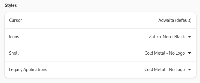

:control_knobs: Step 5: Apply Themes in GNOME Tweaks
  1. Open the Tweaks application
  2. Go to the “Appearance” section
  3. Select your desired:
  • Applications theme
  • Shell theme
  • Icon pack
  • Cursor
:tada: Your desktop is now riced and stylish!

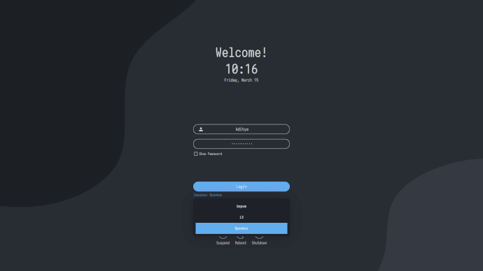

Your Login Manager
Not all SDDM themes found on GitHub work on non-Arch Linux systems. If you find a solution, let me know! :smile:
:gear: Install Requirements for Different Distros
sddm qt6-svg qt6-virtualkeyboard qt6-multimedia-ffmpeg     # Arch
sddm qt6-svg qt6-virtualkeyboard qt6-multimedia            # Void

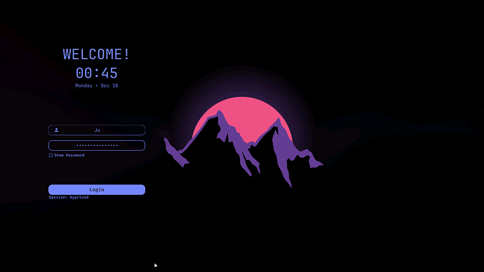

:art: Test Your SDDM Themes (Before Applying)
Preview how themes will look with the greeter:
sddm-greeter --test-mode --theme /usr/share/sddm/themes/maya
sddm-greeter-qt6 --test-mode --theme /usr/share/sddm/themes/sddm-astronaut-theme
:rocket: Recommended Theme: SDDM Astronaut Theme by KeyitDev
KeyitDev’s Astronaut theme is highly recommended for a stunning login screen!
sudo rm -rf /usr/share/sddm/themes/sddm-astronaut-theme
sudo git clone https://github.com/Keyitdev/sddm-astronaut-theme.git /usr/share/sddm/themes/sddm-astronaut-theme
sudo cp /usr/share/sddm/themes/sddm-astronaut-theme/Fonts/* /usr/share/fonts/
sudo tee /etc/sddm.conf > /dev/null <<EOF
InputMethod=
[Theme]
Current=sddm-astronaut-theme
EOF
:bulb: KeyitDev’s work delivers an elegant, modern login experience.
sudo rm -rf /usr/share/sddm/themes/sddm-themes
sudo git clone https://github.com/DarkevilPT/sddm-themes.git /usr/share/sddm/themes/sddm-themes
InputMethod=
[Theme]
Current=sddm-themes
EOF
sddm-greeter --test-mode --theme /usr/share/sddm/themes/sddm-themes
sudo rm -rf /usr/share/sddm/themes/simple-sddm-2
sudo git clone https://github.com/JaKooLit/simple-sddm-2.git /usr/share/sddm/themes/simple-sddm-2
InputMethod=
[Theme]
Current=simple-sddm-2
EOF
sddm-greeter --test-mode --theme /usr/share/sddm/themes/simple-sddm-2

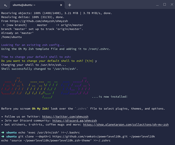

:hammer_and_wrench: Installing Zsh and Oh My Zsh
1. Install Zsh and set it as the default shell:
sudo apt install zsh nano -y
chsh -s $(which zsh)
2. Install Oh My Zsh :
Run the following command to install Oh My Zsh :
sh -c "$(curl -fsSL https://raw.github.com/ohmyzsh/ohmyzsh/master/tools/install.sh)"
When prompted, type Y to set Oh My Zsh as your default shell. This will also create a ~/.zshrc file in your home directory. You can edit this file later.
:arrows_counterclockwise: Make Zsh the Default Shell for Bash
If you’re still using Bash, you can set Zsh as the default by running:
echo 'exec /usr/bin/zsh' >>~/.bashrc
:boom: Install Powerlevel10k Theme
  1. Clone the Powerlevel10k repository :
git clone --depth=1 https://github.com/romkatv/powerlevel10k.git ~/powerlevel10k
  1. Add the Powerlevel10k theme to your ~/.zshrc
echo 'source ~/powerlevel10k/powerlevel10k.zsh-theme' >>~/.zshrc
  1. Change Zsh theme :Open your ~/.zshrc file:
nano ~/.zshrc
Change the ZSH_THEME line to:
ZSH_THEME="powerlevel10k/powerlevel10k"
Save and exit by pressing Ctrl + X , then Y .
:rocket: Final Steps
  1. Open a new terminal window with Ctrl + T and type zsh .Your terminal should now look something like this:
:gear: Configure Powerlevel10k
To enter the Powerlevel10k configuration wizard, run:
p10k configure
:arrows_counterclockwise: Update Powerlevel10k
To update Powerlevel10k , run:
git -C ~/powerlevel10k pull
:stop_sign: Uninstalling Zsh and Oh My Zsh
If you want to remove Zsh , Oh My Zsh , and Powerlevel10k :
  1. Remove Installations & Configurations :
sudo rm -f ~/.p10k.zsh
sudo rm -rf -- ${ZSH_CUSTOM:-$HOME/.oh-my-zsh/custom}/themes/powerlevel10k
sudo sh ~/.oh-my-zsh/tools/uninstall.sh -y
  1. Remove Zsh and related packages :
sudo apt remove zsh -y
sudo apt autoremove -y
  1. Delete Zsh Configuration Files :
sudo rm -Rf ~/.zsh*
With this setup, your terminal should now look sleek and modern with the Powerlevel10k theme. Enjoy!
