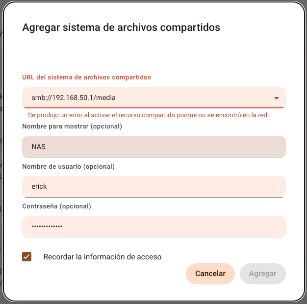

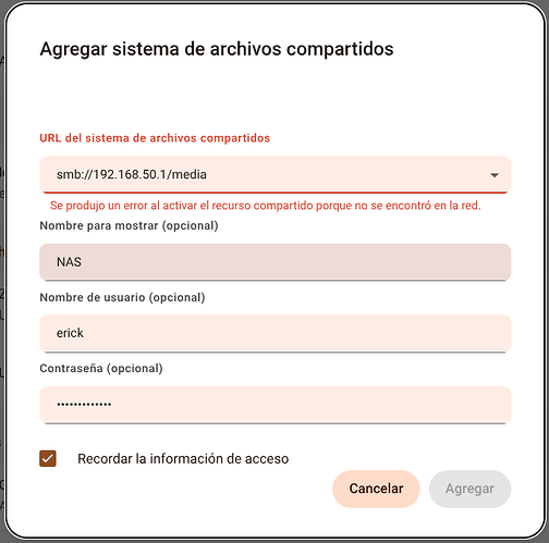

However, trying to access this shared drive on FydeOS gives a “resource not found in network” error:
Please advise on how to configure the samba shared drive to make it usable in FydeOS.
