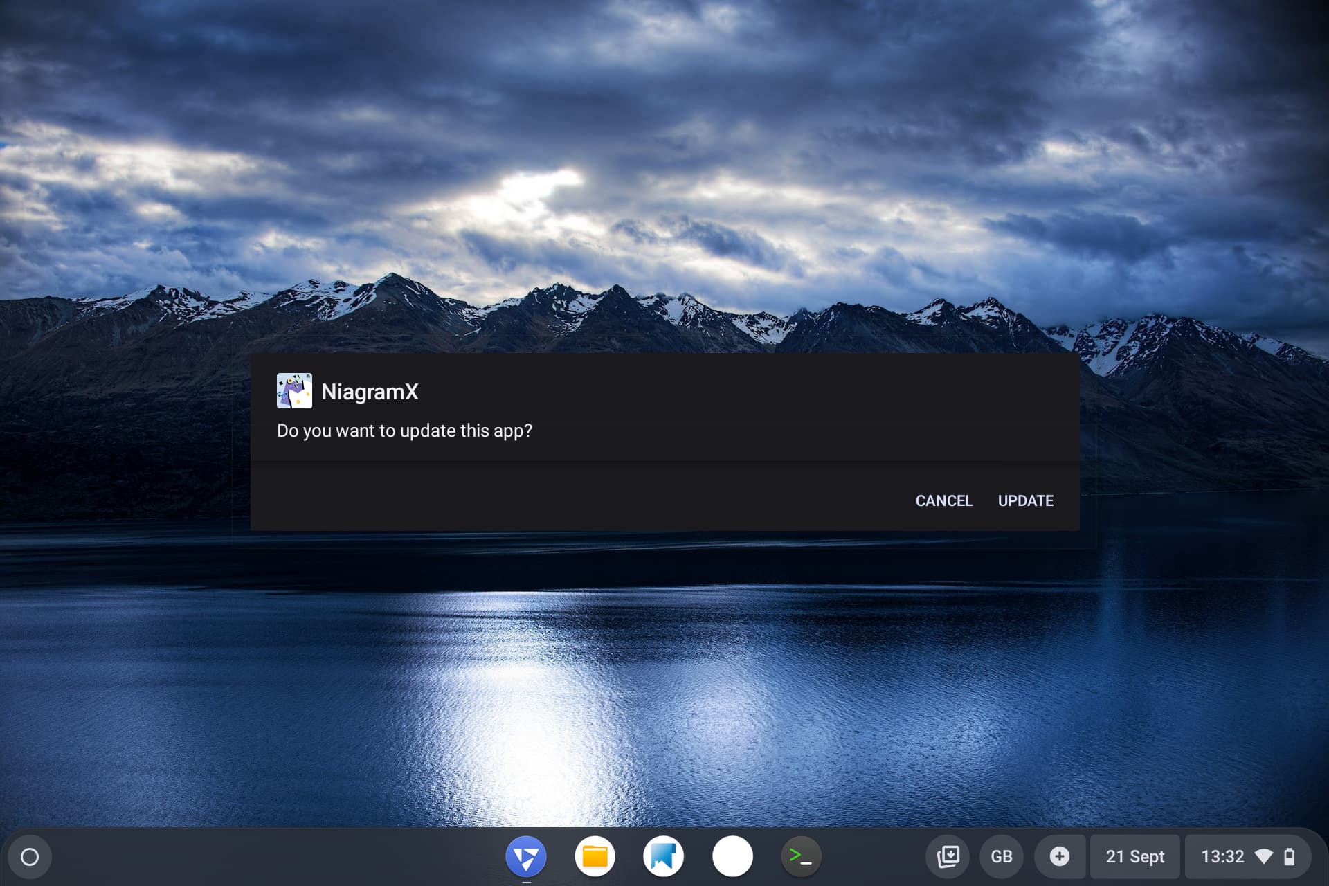

Android dialogs appear normally, but buttons such as CANCEL, UPDATE and other confirmation options cannot be selected with:
  • Touchpad/mouse
  • Touchscreen
  • Keyboard navigation
Clicking a button usually just makes the mouse pointer disappear briefly and then return. Some other controls in the same Android app can still work.

I captured diagnostic information while the faulty dialog was visible. The archive is:

Do you mean you can’t click “Install” on the installation screen shown in the video below? If so, we haven’t been able to reproduce the issue—the button works normally in our tests.
Yes I can’t click the install or cancel button
neither button is clickable with touchscreen or trackpad, all i can is close it from the taskbar

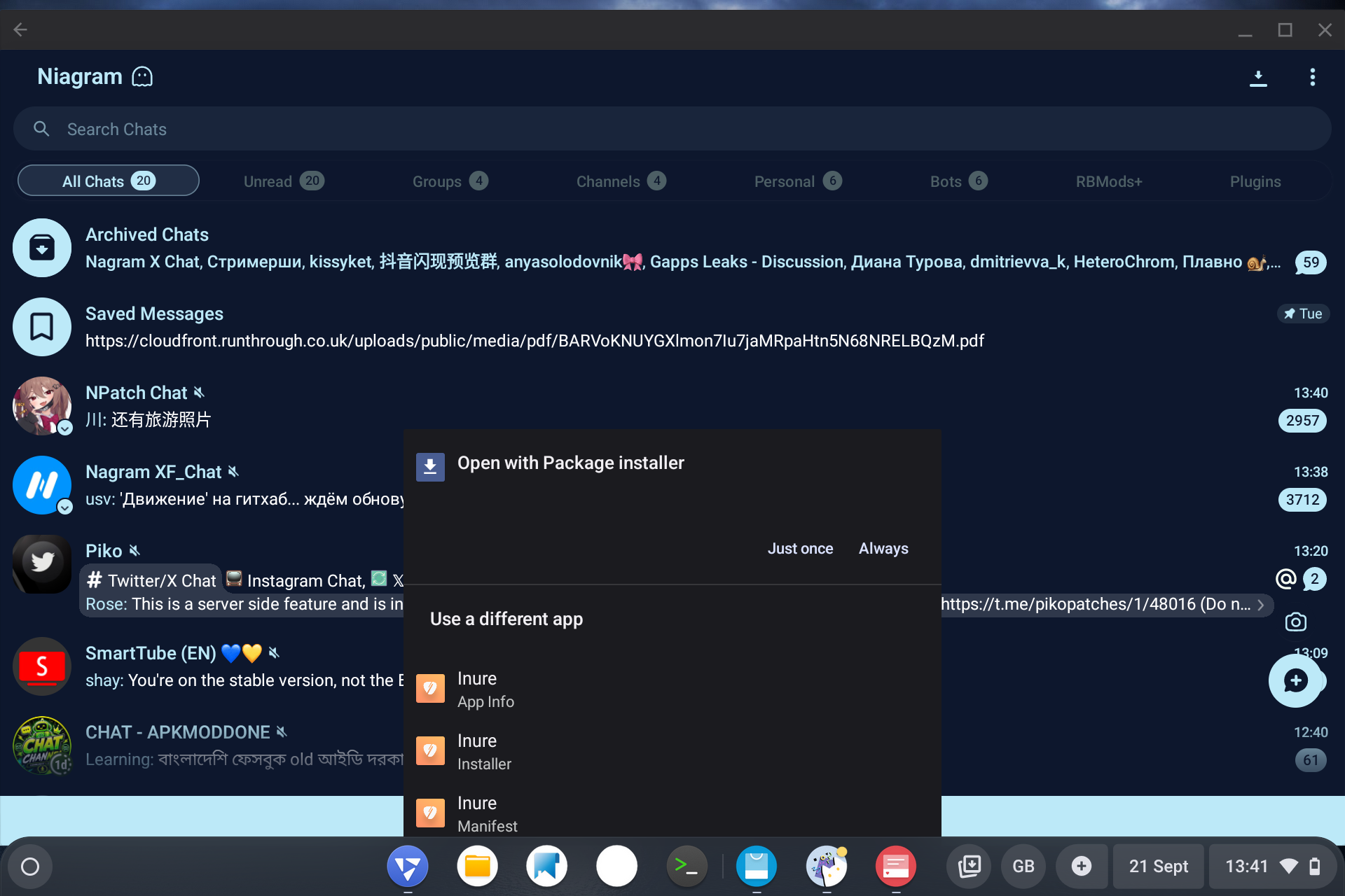

i can install apps from thr fyde os app store that works but installing apps from the aurora store or from telegram wont install, they are the ones unclickable
this is what im on about, I select package installer which opens but the install box is then unclickable
This is the issue with this store app not with apk file installing. It’s totally different. When you install apk file, the popup windows is from the system. But when you install from aurora, the popup window is from aurora.
This is not an Aurora Store bug.
I can reproduce the same problem from Telegram and other Android applications. Aurora is simply one application capable of triggering the affected installer.

Do you mean that when you select “Install” directly in Aurora Store, the confirmation dialog appears, but its buttons don’t respond to clicks? If so, we haven’t been able to reproduce this issue. We tried installing several apps through Aurora Store, and the buttons in the confirmation dialog worked normally each time.
Not just aurora, telegram as well. It’s a different package installation UI that pops up than if I use fydeos app store like a legacy pop-up or something (it gives me the choice between innure package installer or default) which ever I pick gives me a popup unclickable. The fydeos app store doesn’t offer me the choice of installer that’s the big difference

  3. Android’s separate Package Installer window appears with Cancel and Install/Update buttons.
  4. Attempt to select either button using:
    • Type Cover touchpad
    • Touchscreen
  5. Neither button responds. With the touchpad, the pointer briefly disappears and then returns.

This should have nothing to do with the device. I installed several APKs on Aurora on my Surface Go 2, and the pop-up windows were all uniform system-like windows, and they could all be tapped normally. They’re different from the pop-up window in your screenshot. It should only be reproducible on certain Android apps.
