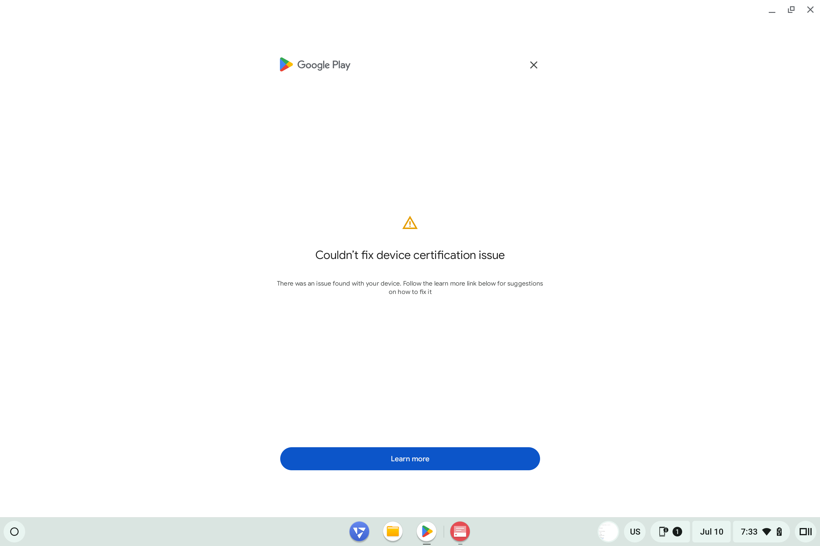

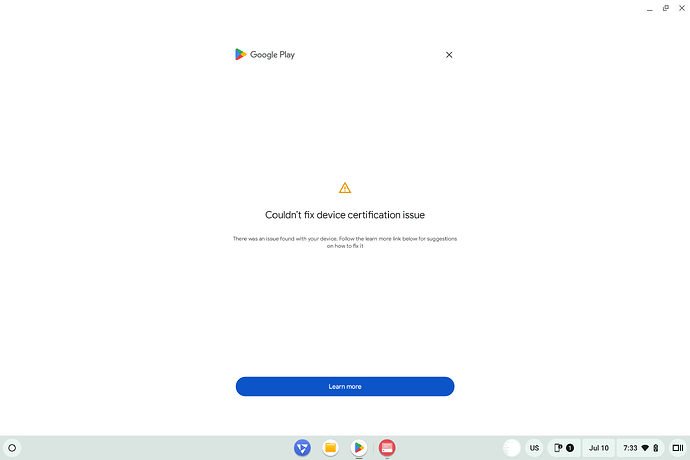

Hello I am now having another problem i am having this problem now. I have been trying to figure this out and I can’t figure it out. If anyone knows how to fix this please help. I have restarted 3 times, cleared out cache/data for both google play services and google play store nothing has worked please help
![Screenshot 2025-07-10 7.33.40 PM|690x460]
(upload://yJ09psFSlDnjuSIxZFVekJSL5m5.png)
Did you follow the guide? Disable root verification and then install open gapps.

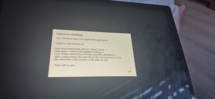

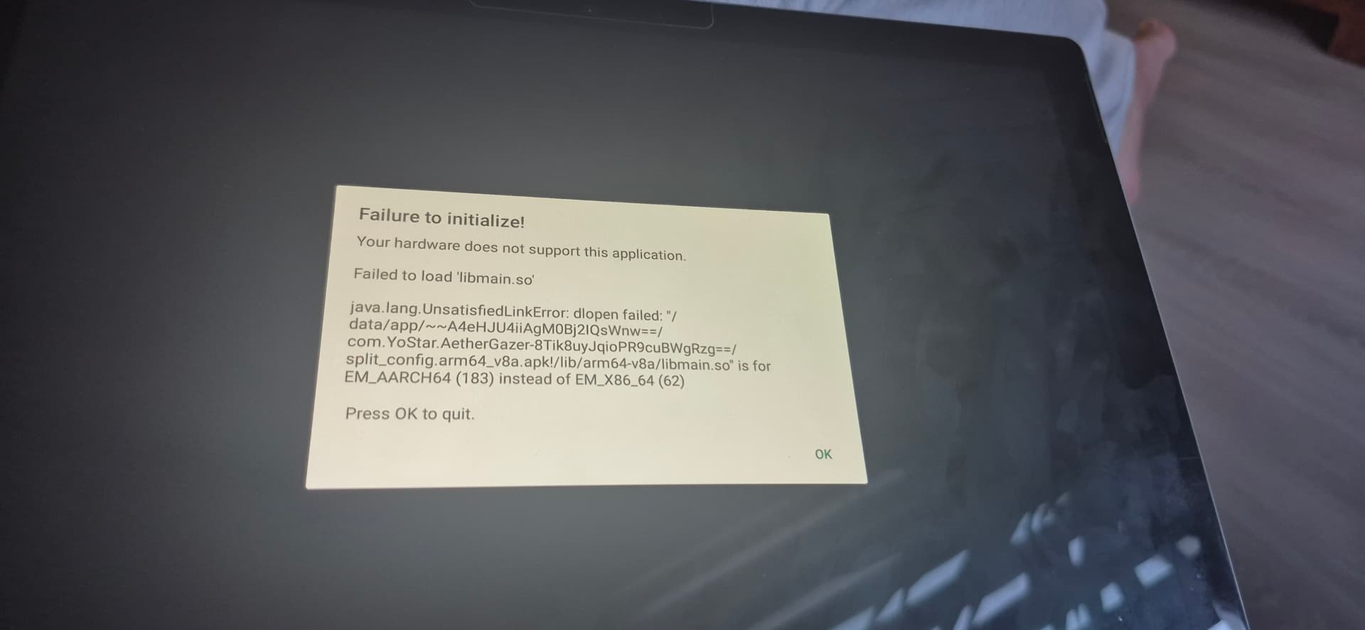

I can try to reinstall it again and see if that fixes the problem.
Looks like houdini is missing
