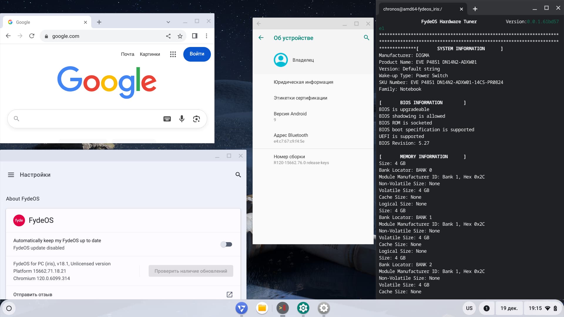

I created my own FydeOS 18.1 Iris image for my laptop Digma p4851 (copy of Chuwi GemiBook plus) Alderlake N200 .
I patched the image for writing, updated the kernel to 6.6.13, added the WiFi firmware, and modified grub.cfg.
i tested my img and it works perfectly on the laptop Digma EVE P4851 laptop, Chuwi GemiBook plus, and HP 250 G7, and minipc MllseG3, as well as on a computer with an cpu i3-8100.

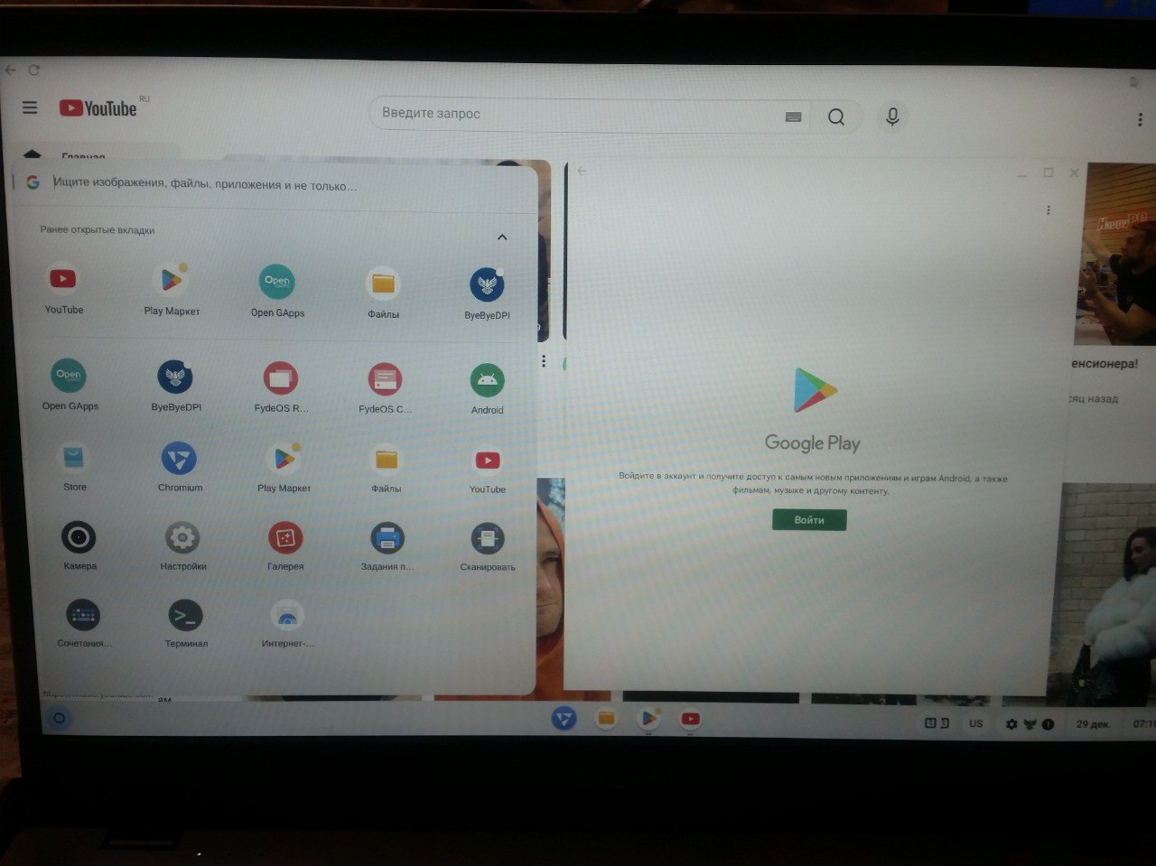

It has Android, which runs well. I launched many games and they worked.
Dual boot works too.
You can run it from a flash drive and from ventoy.
Try my img of FydeOS iris 18.1 with working Android 9

also will gapp work so i can download play store
yes, fydeos is a intenational os, you can change own lang on setup stage. Open Gapps (google play ) is working too.
