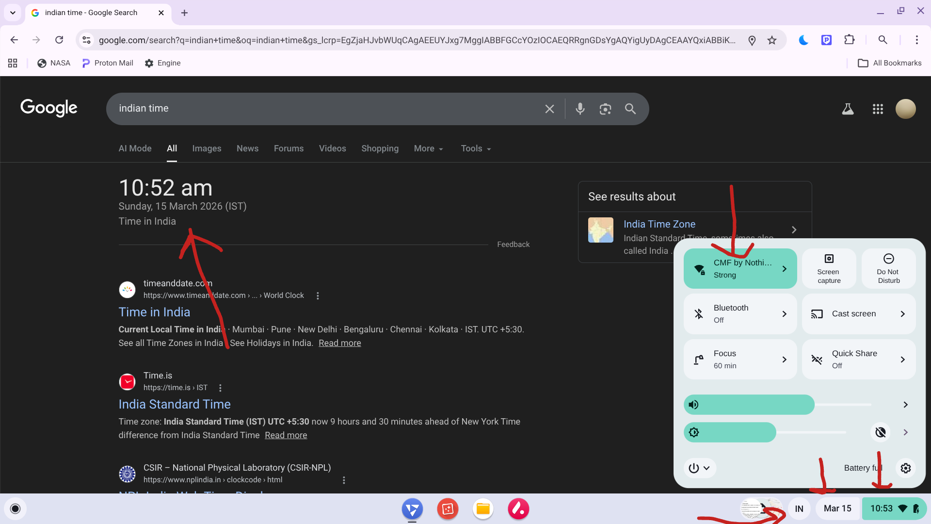

  • Hello everyone , i neeed help regarding the wrong synchronization of time zone as well as geolocation.actally my Time Zone is India (GMT+5:30)

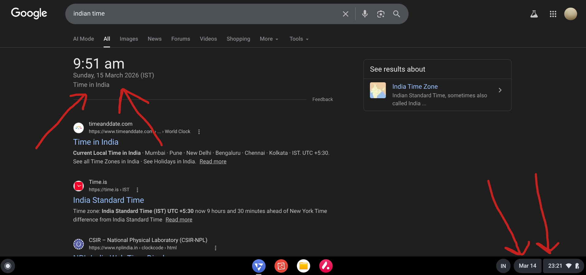

    & when im writing this the timezone in my laptop is (UTC-5:00) Central Daylight Time (Chicago) It is 11:00 AM in Chicago. like in morning in india it automatically switches to dark theme and in night it switches to light theme.

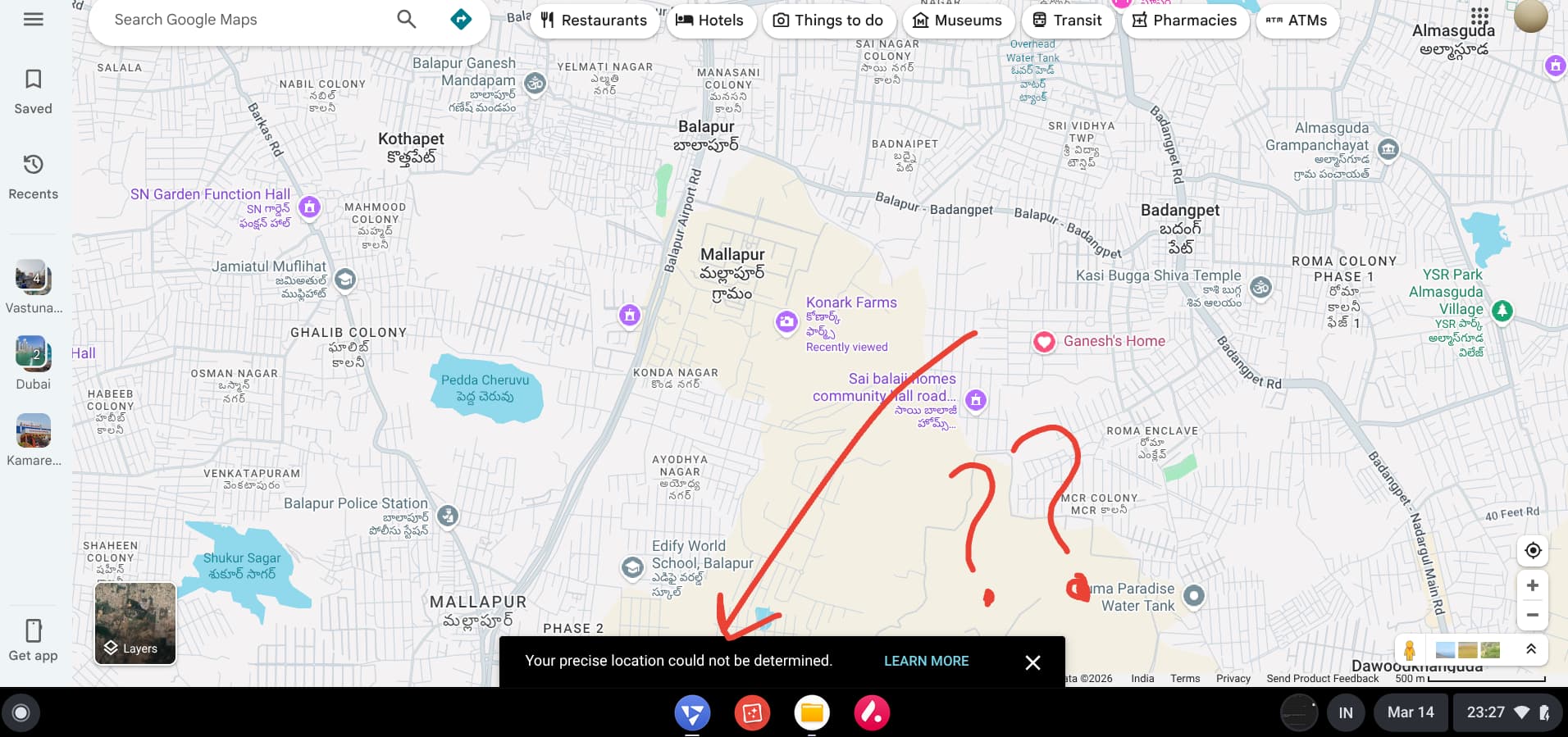

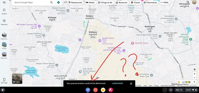

my laptop has GPS and inearlier fyde os version it used to detect my exact location but in v22 google maps is unable to detect my location like whats going on.
i also tried to manually change time zone it just appears at bottom actual indian time but the system follows the same chicago time for auto dark/light theme.
and one last thing when i connect my fyde os device to my mobile hotspot everything here works perfectly time is synchronized and also auto dark/light theme works perfectly.

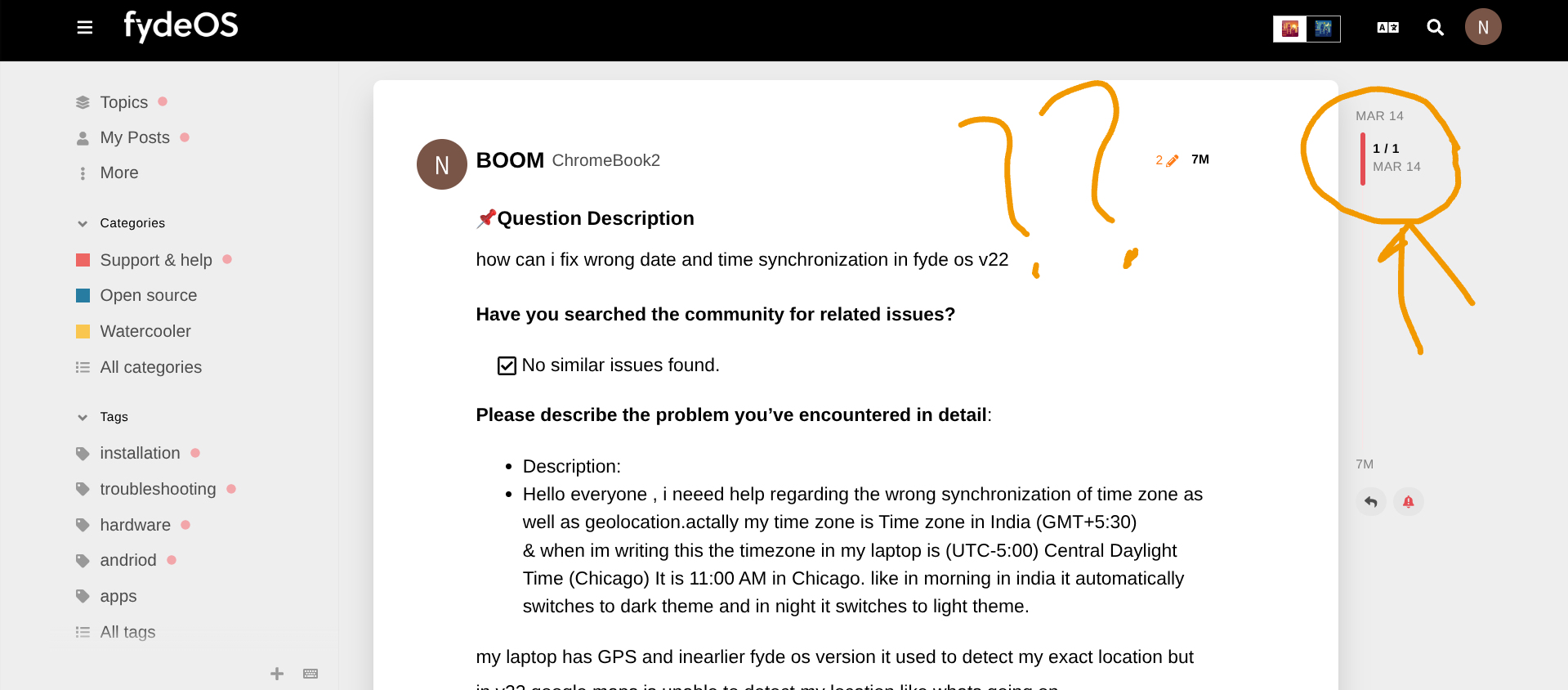

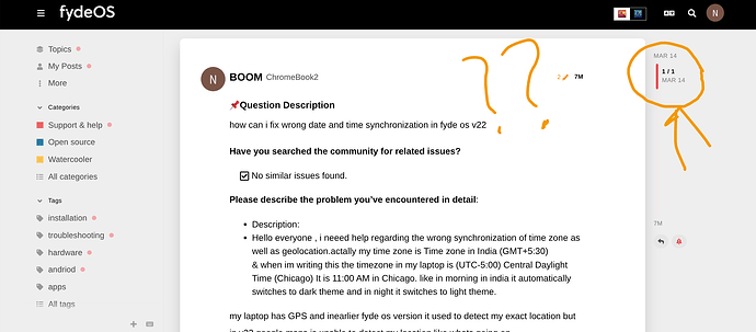

even this post itself is posted on wrong date and time which is not at all mine

screenshots:
FydeOS determines the timezone based on the public IP address of your network, not GPS. The IP location comes from a free public IP database, which may sometimes be inaccurate.
The issue you are seeing is most likely because the IP address provided by your internet provider is incorrectly mapped in the database. You can try restarting your router to obtain a new IP address.

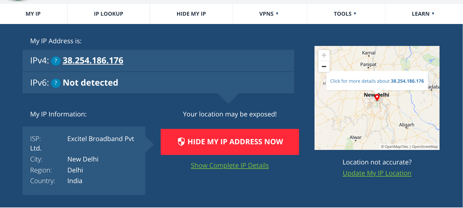

and one more thing when i cheecked my ip adress it showed NewDelhi which is in india.
