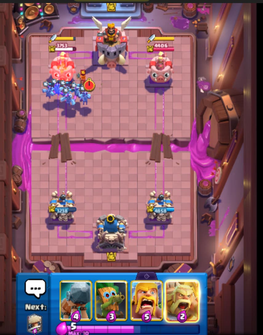

This isn’t exactly a big issue but I’m still wondering if it can be fixed, in games like clash royale, the quality was crystal clear and was very high quality. after the upgrade from 22 to 23, while I had noticed there’s less stutters and runs very smoothly, everything looks more pixelated, and small text is now barely readable, I’ve tried looking to see if anyone else had the same issue and no dice. any help would be appreciated!!

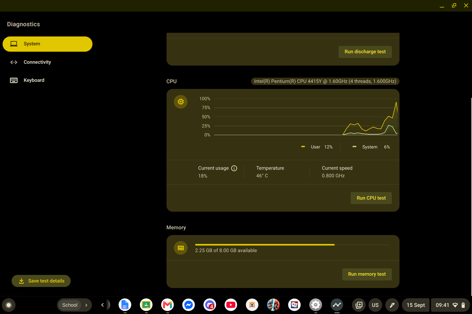

my system is a surface go 1st gen running FydeOS For You with a valid license
To help Android apps run smoothly on devices with 4GB of RAM, Android games currently run at a lower resolution by default. We’ll add an option to adjust the resolution in a future update, so you can choose a higher or lower resolution based on your device’s specifications.
I do understand that, but my specific surface model is the 8gb model…
