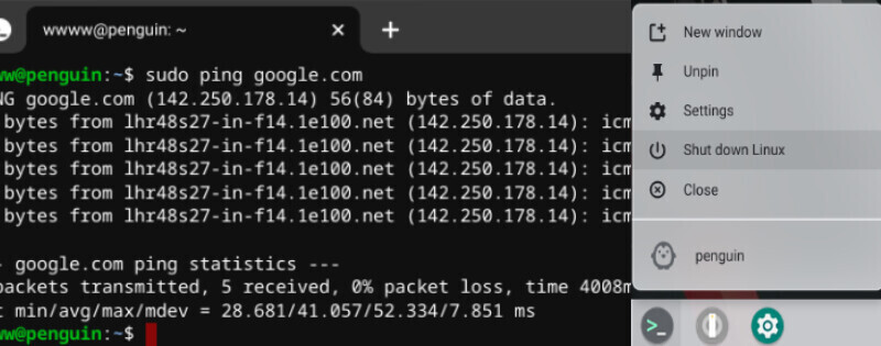

🖱️Terminal Troubleshoot🖱️
Sometimes when the linux terminal jams a sudo reboot/poweroff or a Crosh vmc stop/start termina fixes it.
  • sudo ping google.com doesn’t work or… wierd launch error messages… etc…
#Open Chromium Browser - Ctrl Alt T
vmc stop termina
vmc start termina or vmc launch termina #ChromeOS is start FydeOS is Launch
#Some screen glitching can be fixed with this:
systemctl --user restart sommelier{,-x}@{0,1}.service
chrome://restart

Always make sure your terminal has internet by doing sudo ping google.com and Ctrl C to stop at each reboot before typing instructions.

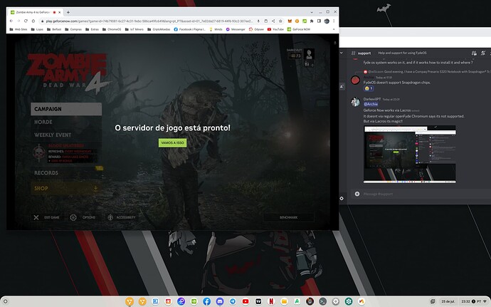

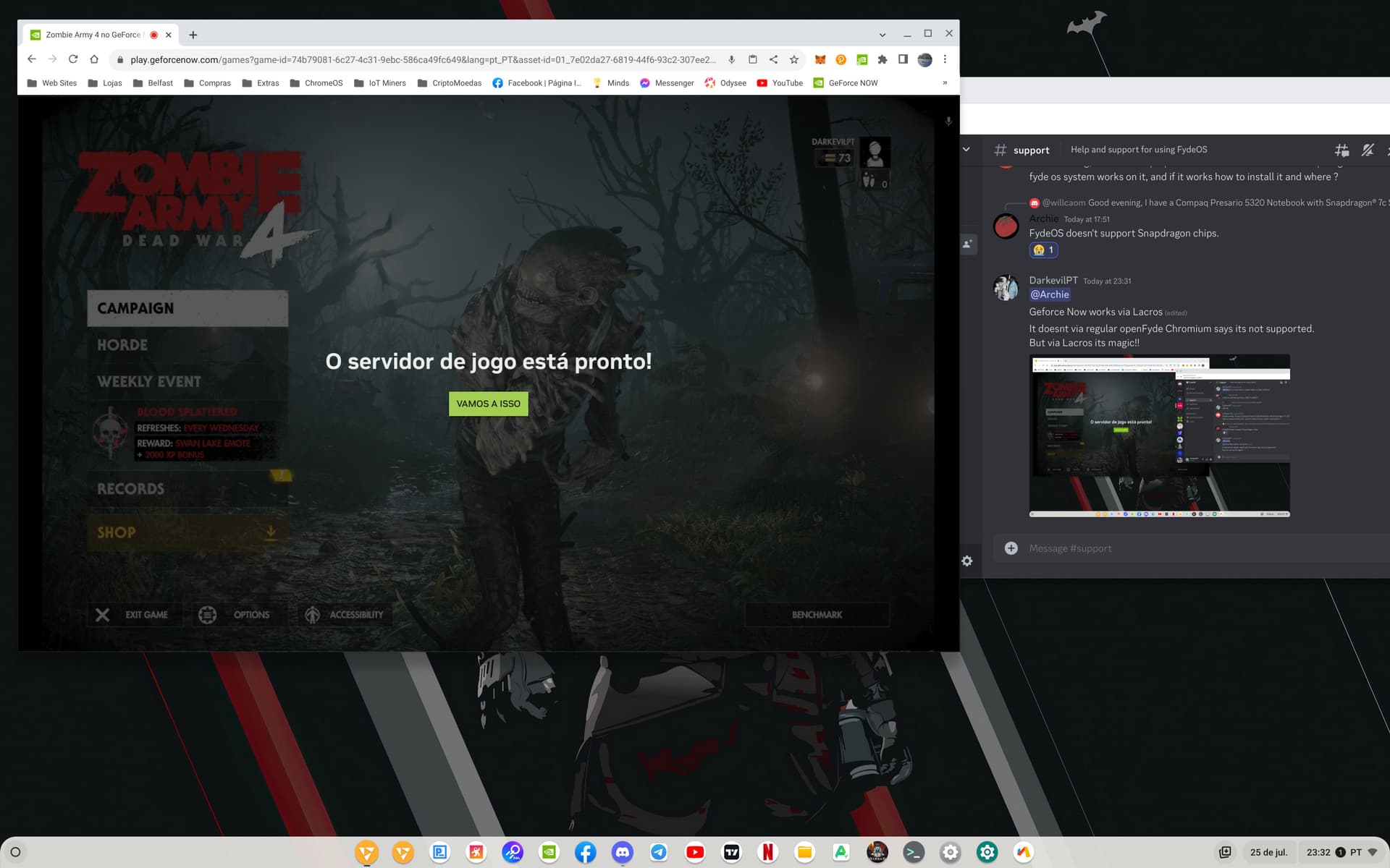

:boom: Cloud Gaming! :cloud:
  • Geforce Now states fydeos/openfyde browser as unsupported.
  • #lacros-only doesn’t work anymore and google can make it chromebook exclusive.
Solution for Geforce Now on openFydeOS Debian Chrome Browser
🖱️Install Flathub Debian Browser:🖱️
sudo apt install flatpak gnome-software-plugin-flatpak -y
sudo flatpak remote-add --if-not-exists flathub https://dl.flathub.org/repo/flathub.flatpakrepo
sudo flatpak install flathub org.chromium.Chromium -y
sudo flatpak update -y
FlatHub Debian Browser: flatpak run org.chromium.Chromium
Access: https://play.geforcenow.com/mall/#/layout/games
🖱️Change mouse colour to fix invisible FlatHub cursor:🖱️
On System, go to “Settings” → “Accessibility” → “Manage accessibility features” → “Mouse and touchpad.”
Toggle on “Highlight the mouse cursor when it’s moving”.
🖱️How to uninstall flatpak:🖱️
flatpak uninstall --unused
sudo apt-get remove --autoremove flatpak
sudo apt-get purge flatpak
(Tip) To keep image steady without pixelation is to cut the gimmick crap by setting it to 30 FPS without Auto Adjust for Poor Network Conditions.
You can now enjoy playing games on Geforce now with an huge quality like a champ! Finally.

crosh Ctrl Alt T:
vmc start termina --kernel /home/chronos/user/MyFiles/kernel
vmc container termina penguin --privileged true
For open/FydeOS
sudo apt update ; sudo apt upgrade -y ; sudo apt install lsb-release wget software-properties-common gnupg make -y
wget https://gist.githubusercontent.com/DarkevilPT/a7be7d5f6dd57bb893c1d93403176cf4/raw/b48dcc0ced2bf22ad9256fc29fc595a85349c47d/build-termina-kernel.sh
/bin/bash ./build-termina-kernel.sh
crosh Ctrl Alt T:
vmc launch termina --kernel /home/chronos/#user/MyFiles/kernel
